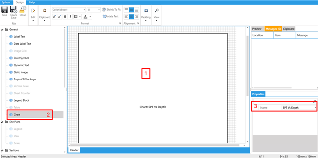

Once a Chart has been created in the Chart Manager, it can be added to a Project Sheet or a Header Sheet by following the steps below:-
  1. Select the merged area to insert the chart into
  2. Double click on the Chart item in the general Section of the Objects Tree
  3. Select the required Chart from the properties dropdown
