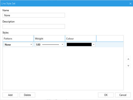

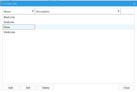

Adding / Editing a Line Style Set.
Line Style Sets can be added and edited using the “Add” or “Edit” button on the Line Set Manager (as shown below)
Each Line Style Set has the following properties: Name, Description, and a set of Line Styles.  These are shown in the Line Set Manager form as shown below.
To create a “None” Style set create a new set called “none” with a single line style with a “None” pattern (as shown above)
