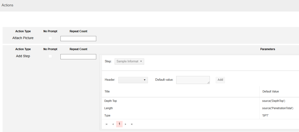

Default Value expressions can be used to populate default values when an OpenGround Data Collector form is loaded.
Default Values can also be supplied as part of an 'Add Step' Action. Note the use of the source() function to utilize a value from the original Step as a default value in the Action Step:

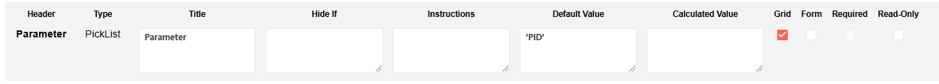

This expression sets the default value to B. This works well for pick list items:
'B'
