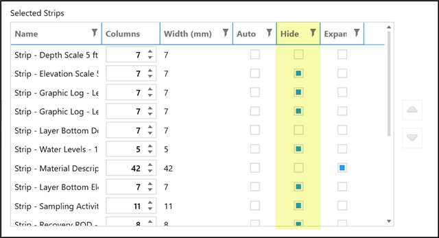

How to build Master Templates and Strip Sets are already detailed here for Master Templates and here for Strip Sets. There is also the nuance of the show/hide conditions that must be used on the individual strips.
Top Tip: If a strip has a hide condition on it, the hide condition is not enacted until you select "Hide" in the Master Strip Sets window as shown below.

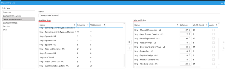

Also, the strip sets bundle and refer to those strips living outside the report.
This means you need only create any strip once and use it in different strips sets and/or reports
If you need to change something to a strip, it effects every strip set that refers to it: Create once, use in many places.

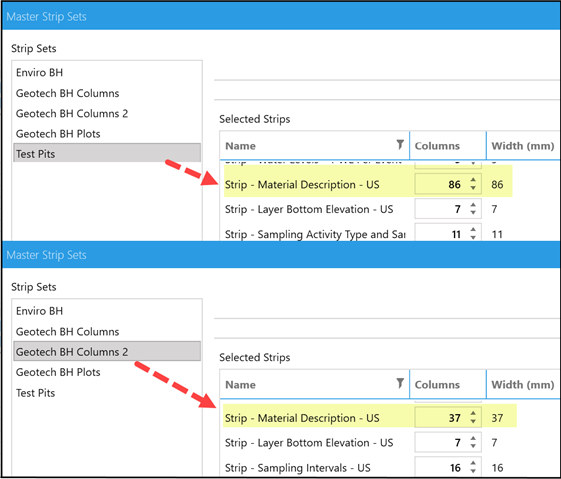

Finally, the Master Strip Set window also lets you modify the width of a strip used in the strip set without effecting the original strip. This is useful when you are creating a test pit report which typically has fewer depth related columns than an drilled borehole.
