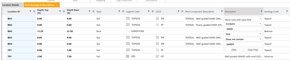

Filter
Filters are helpful to ask a little more of your data on any table without getting too in depth or committed to one question. You can quickly filter for something like sand below 15 feet, or N values <5 at depths greater than 15 feet, etc.
What this means is in a single grid you can use filters in two or more columns to get a little more specific in your search without getting too complex. Of course, it can take a little learning to ask the question correctly and not get back "bad data" but we all learn by trial and error. And this is a quick tool to create and clear queries. You are not commited. You are asking simple engineering questions that may effect your design recommendations and seeing the response.

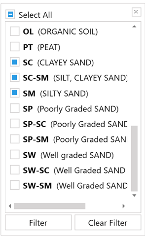

Depending on the field type, the filter will be different. For drop down lists, you can select specific list items.
For text and numeric fields you can use selection criteria such as greater than, less than, contains, does not contain, etc.
In the example above note that "Sandy" is filtered out, but you still get "...with sand" as well as "SAND" in the results. This actually lets you review where all the sand is present, see the descriptions, and get that feel for the site. You can use the filter for USCS to filter out the "GP" or another filter using depth criteria to better understand what is across your site.
