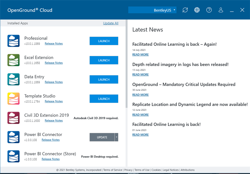

The Launcher is the main starting point of OpenGround. You will be able to access Professional plus any of the extensions including Template Studio.

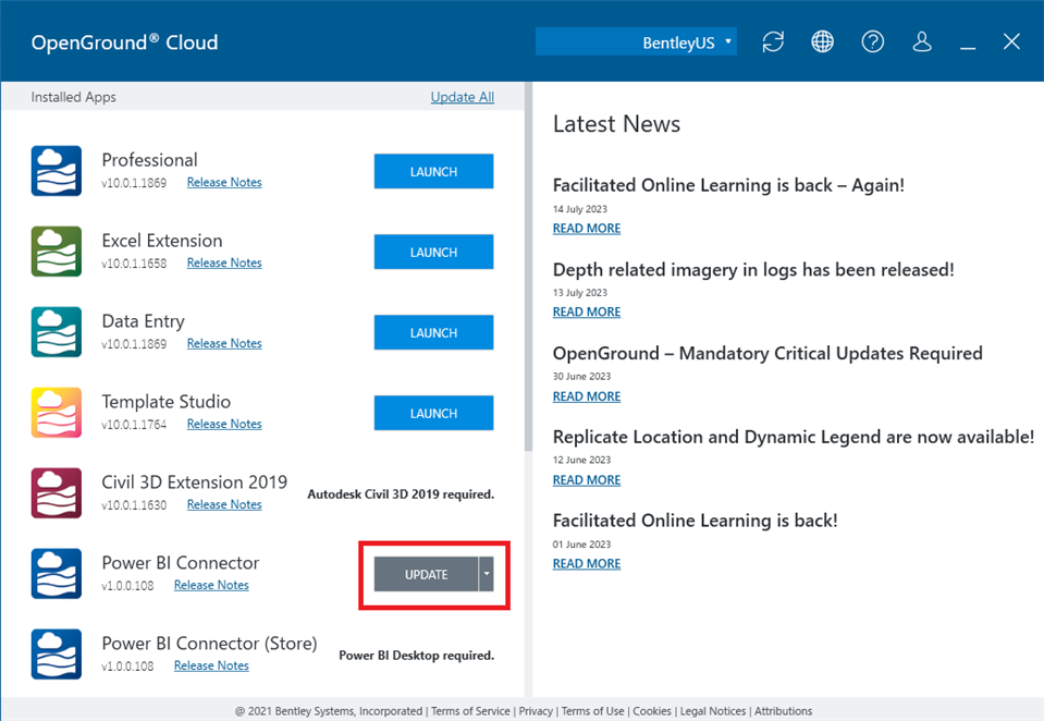

As OpenGround is a platform that is being actively developed we will release updates. These updates look like a grey update button. You don't need admin rights to install these updates. This will always mean you are running the latest version of the applications. We will release bug fixes as well as new features.

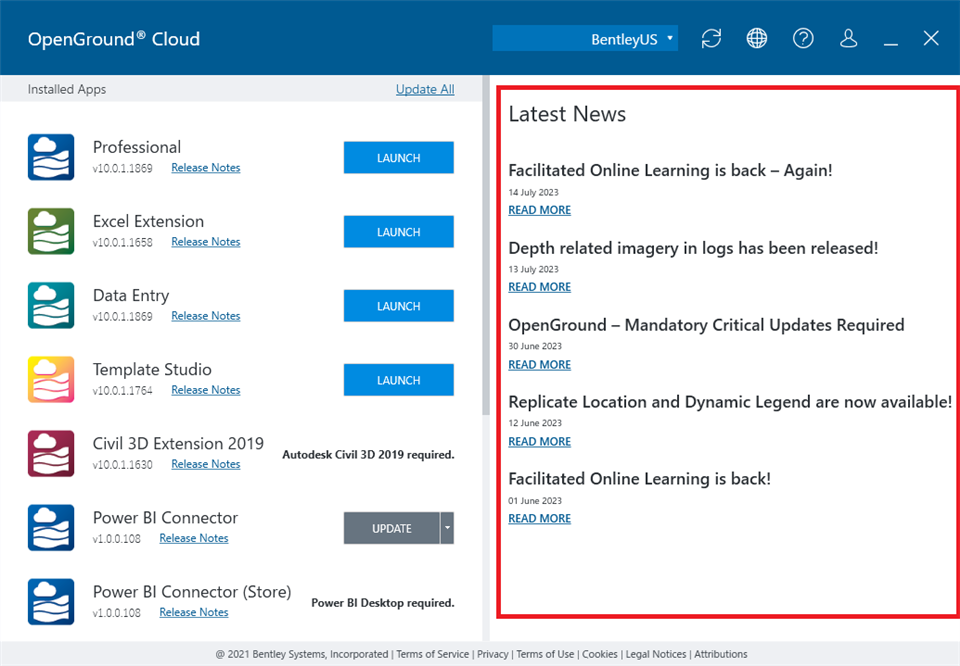

The news section will have links to articles related to what is going on with the platform and anything which might be relevant for users. these can include:
It's a good place to get news and stay connected to what is going on within the OpenGround Community.

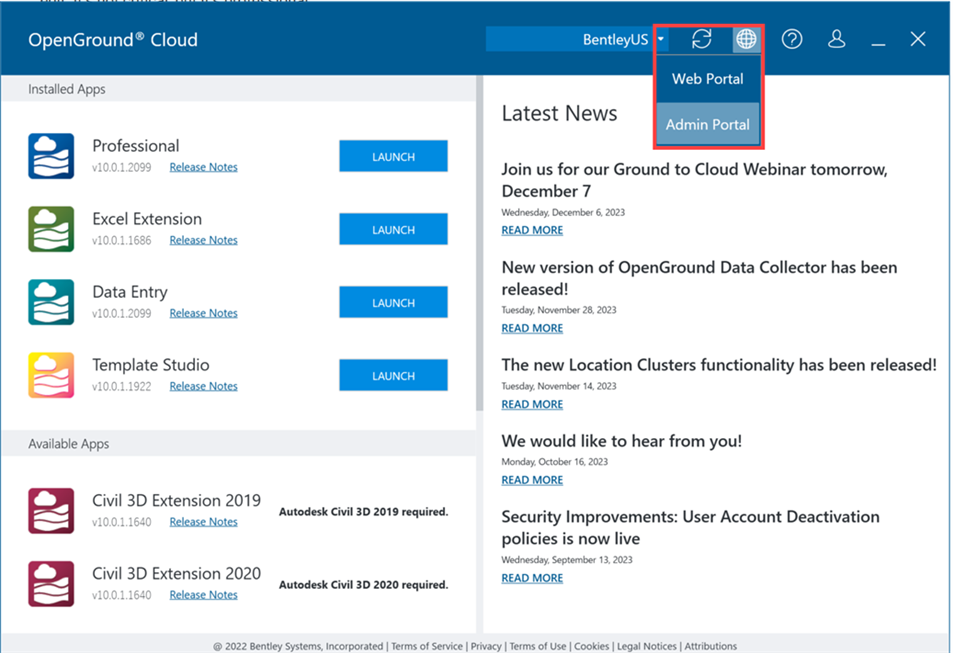

From the Launcher you can access the Admin Portal and Web Portal. The Web Portal is a basic application that allows for view locations on a map, importing data, generating logs, and viewing documents attached to a location. The Admin Portal is where Collector Profiles are created, modified, and managed.

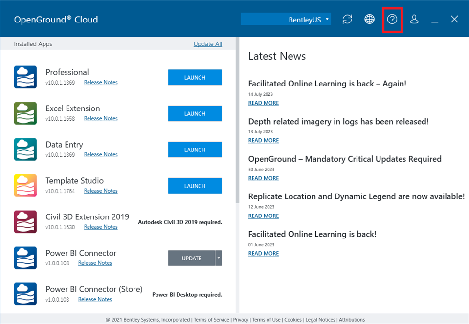

There are a number of ways to get help. From the Launcher you can select the question mark in the top right corner which will take you to the main Wiki landing page.
If you need Technical Support please follow the link for submitting a support case and how the technical support team will be able to help you.

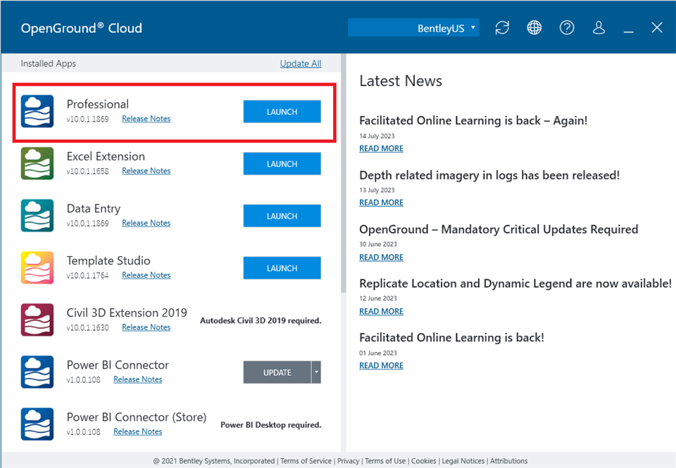

To move forward select Professional at the top of the application list on the Launcher.
