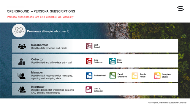

What licences do I need to access the different OpenGround Apps?
There are a number of different licence personas available to allow users to access OpenGround. The following image explains what licence personas allow for which access;

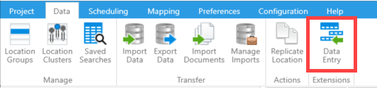

(Note that it is possible to open Data Entry from within the Professional application using the Data>Data Entry button within a project, thus using the Manager licence instead of a Collector one.)
