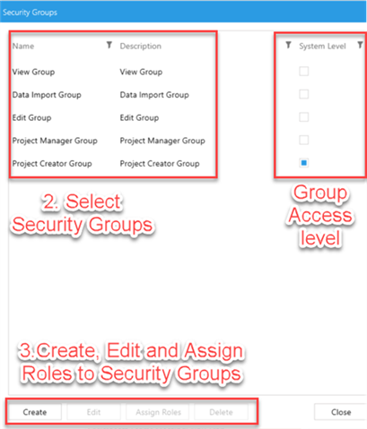

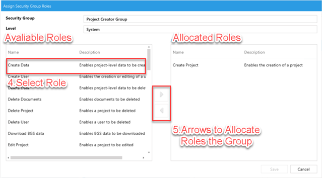

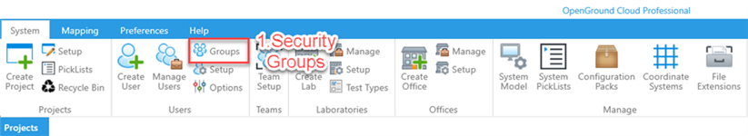

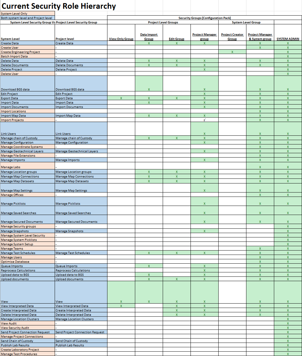

Security groups and roles
Security groups bundle individual security roles. System-level and project-level groups can contain different role options. Review group membership before assigning it; OpenGround does not allow deletion of a group that is already assigned to a user.
Controls for managing security groups
Example system-level security group
Example project-level security group

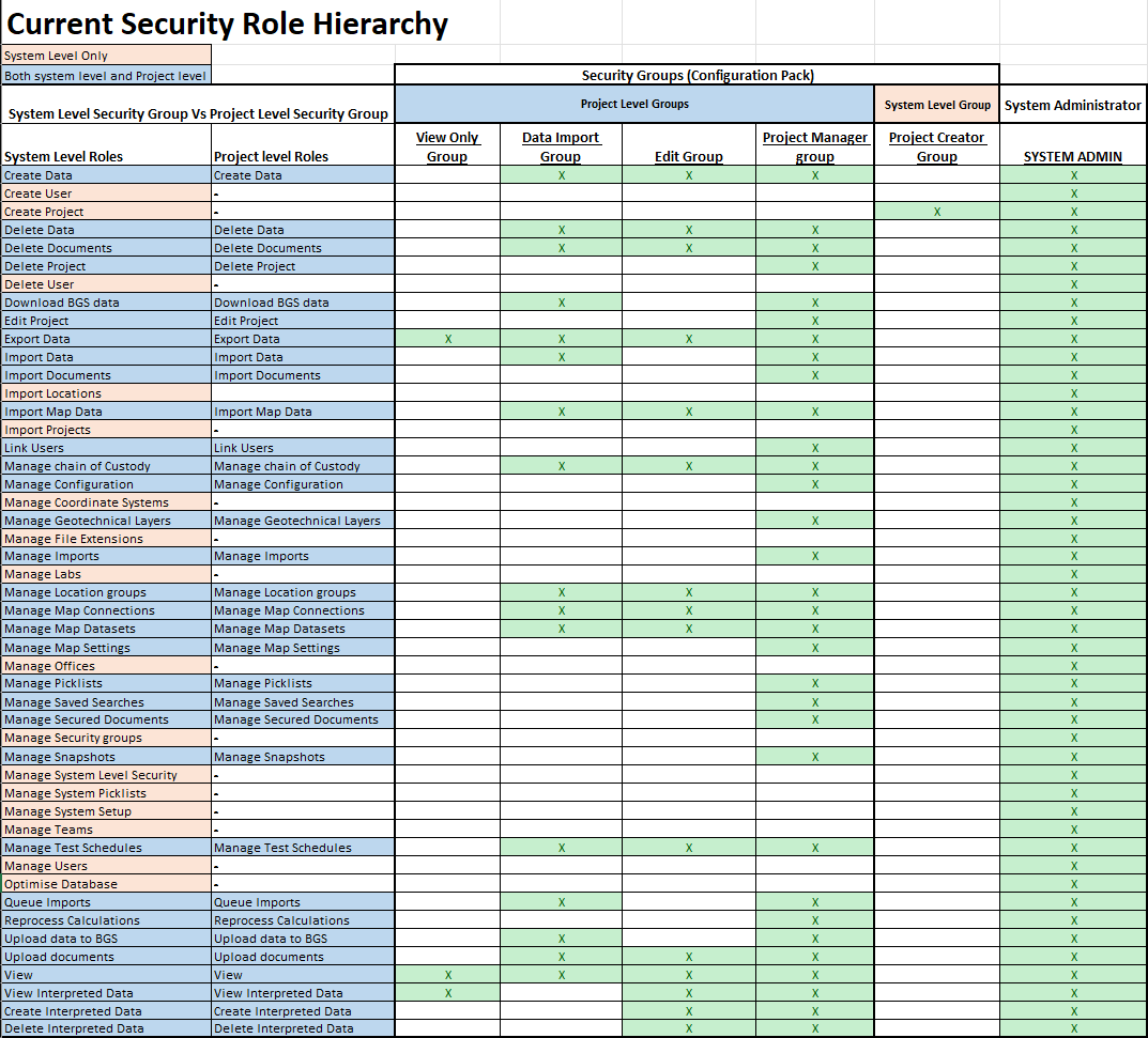

Permission precedence: Roles assigned through System-level access can override more restrictive Project-level access. For example, a system-level Edit Data role can allow editing even when a project-level group only grants View Data. Review overlapping roles carefully and avoid broader system roles unless they are required.
Reference list of OpenGround security roles

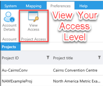

View your access

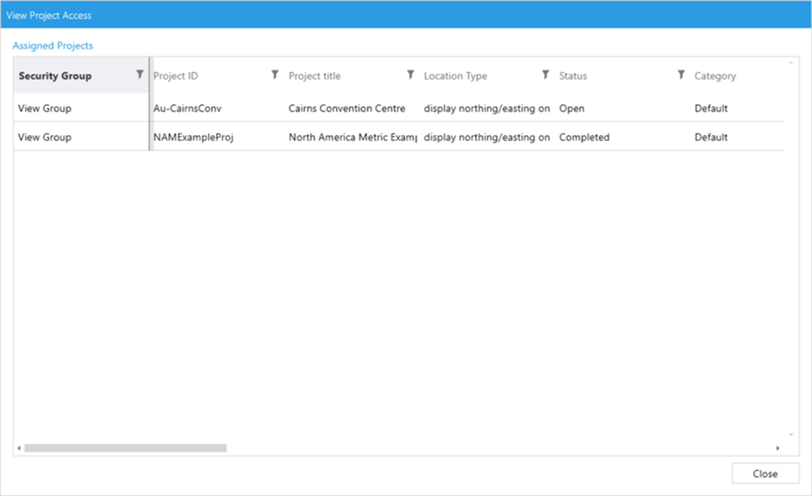

Users who are not System Administrators can review their project security groups from the Preferences tab by selecting View Access. The dialog is read-only and lists projects and their associated groups.
View Access control in Preferences
Read-only list of project access groups
