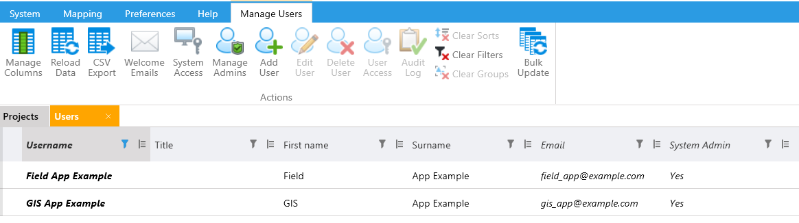

Client Credentials (Machine Login)
For Machine authentication, you will need to create a 'service account' user in your cloud with the appropriate access levels assigned. Assign the user a generic (fake) email address. It doesn't need to be a working email address and shouldn't be an actual user's email. The Client ID will be linked to this service account.
If you are developing multiple apps, create a service account user in the cloud for each app.
For example, below we have created 2 service account "users" - one will be associated with the Client ID for a GIS application and one that will be associated with the Client ID for a Field application. Both user accounts have been assigned as System Admins so these applications will have full access to the cloud instance.
If you are a developer who is new to working with OpenGround, you may not have sufficient permissions or familiarity to create a new user for the service account. If this is the case, we suggest contacting one of your internal OpenGround System Administrators who will be able to assist further.
