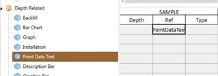

The Point Data Text Object inserts a text value from any data table at a specified height on the Log.
To insert a Point Data Text Object into a column, follow the steps below:

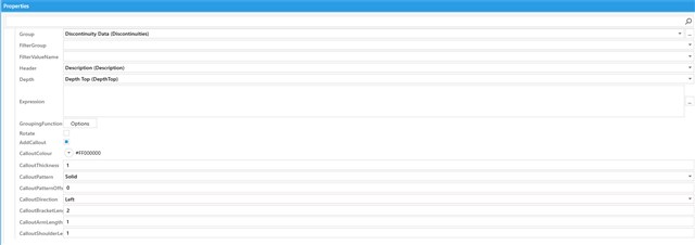

AddCallout – Check box to toggle on and off Callouts on the Point Data Text Object.
CalloutColor - Choose the color you want the Callout to be, this must be set (we recommend #FF000000 for black).
CalloutThickness – Thickness of the CalloutPattern (linetype). (Use 1 as a starting point).
CalloutPattern – This property sets the line pattern (Solid, dash etc..) Must be set (Set to Solid so line will show if you are unsure).
CalloutPatternOffset – used when needed to offset the line pattern (Set to 0 in most cases).
CalloutDirection – Determines which side or both the callout will be placed Choose one (Left, Right, Both).

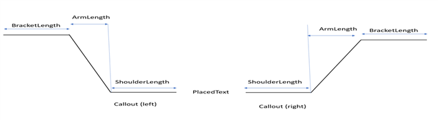

CalloutBracketLength – See diagram below. Where you set the length of the bracket portion of the callout (Set to 1 is a good starting point).
CalloutArmLength – See diagram below. Where you set the length of the arm portion of the callout (Set to 1 is a good starting point).
CalloutShoulderLength - See diagram below. Where you set the length of the shoulder portion of the callout (Set to 1 is a good starting point).
If table name is unknown, then press the button on the right of the Group box and the Project Explorer opens as it appears in HBSI from where you can make the selection.
Block Align Property
“Block Align” property defines the center point of how your text block should display. If property is unchecked, the center will be assumed to be the first line of text. If property is checked, the center will be defined at the center of the entire block of text. Examples of this implementation can be found in the sketch below.
This property is available for “Point Data Text”, “Range Data Text” reference objects.
