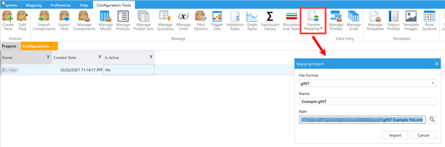

Importing a Mapping File into a Configuration Pack
Within OpenGround Professional, go to System>Configuration Packs>Transfer Mapping with the desired configuration pack selected. Then select Upload – Import XML Mapping or Upload – Export XML Mapping as appropriate.
Select the appropriate File Format for which the mapping file is intended. Enter a Name for the mapping. If you enter a Name that is already used for that File Format, the existing mapping will be overwritten.
When you click Import, the upload process will check the validity of the mappings and report any errors that are encountered. If no errors are encountered, the file will successfully import.

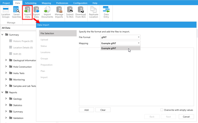

When you go into a project for that configuration pack, you should now see the new mapping under the appropriate File Format under Data>Import Data.

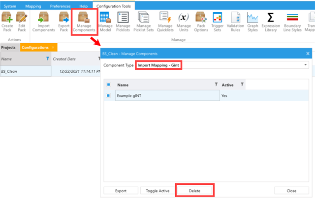

Deleting a Mapping File
Mapping files can be deleted under System>Configuration Pack>Manage Components.
Select the appropriate Import Mapping Component Type (or Export Mapping). Select the mapping(s) you'd like to delete and click Delete.
