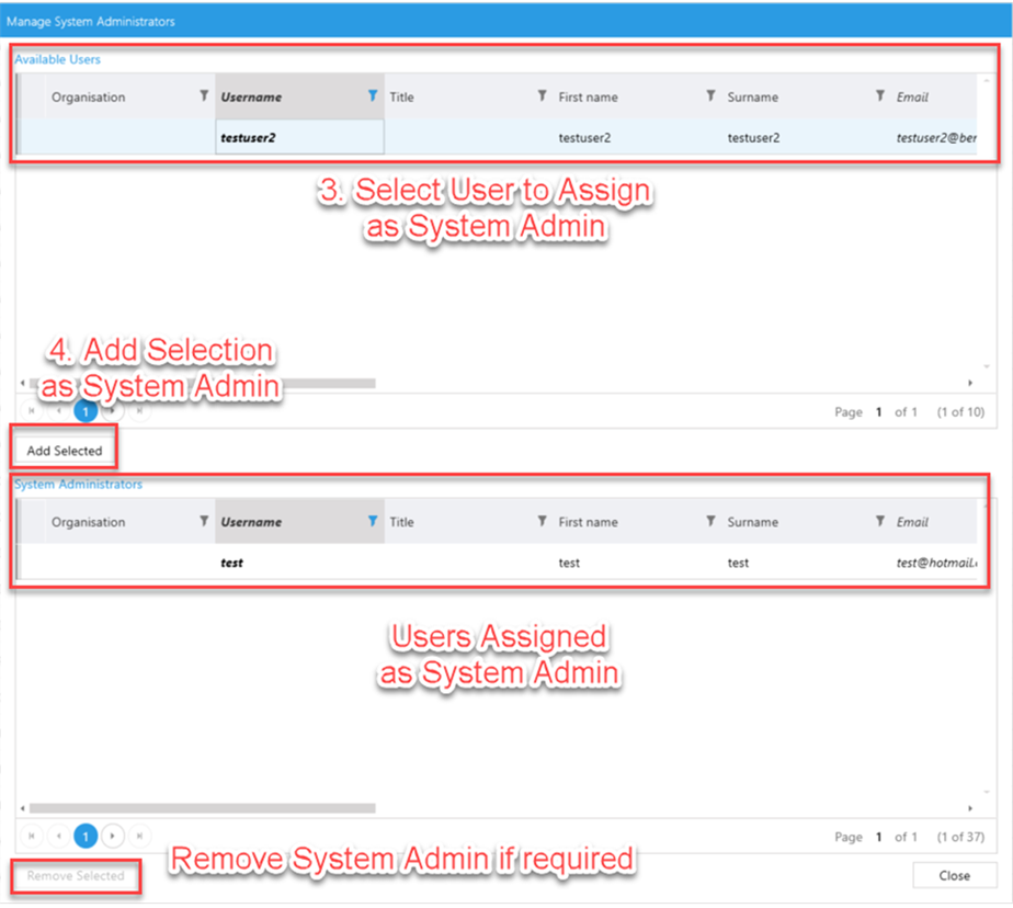

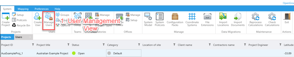

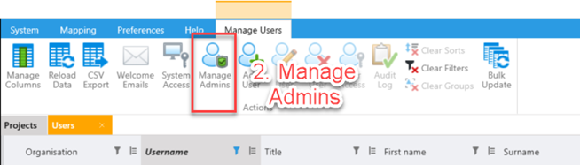

Use this access sparingly. System Administrator access is unrestricted across the OpenGround environment and cannot be limited by project permissions. Assign it only to trusted administrators who need full system control.
In User Management, use Manage Admins to assign administrator access. Select only the intended account and verify the assignment after saving. The screenshots below show the available controls and sequence.
First screenshot in the system administrator assignment sequence
Second screenshot in the system administrator assignment sequence
Final screenshot in the system administrator assignment sequence
