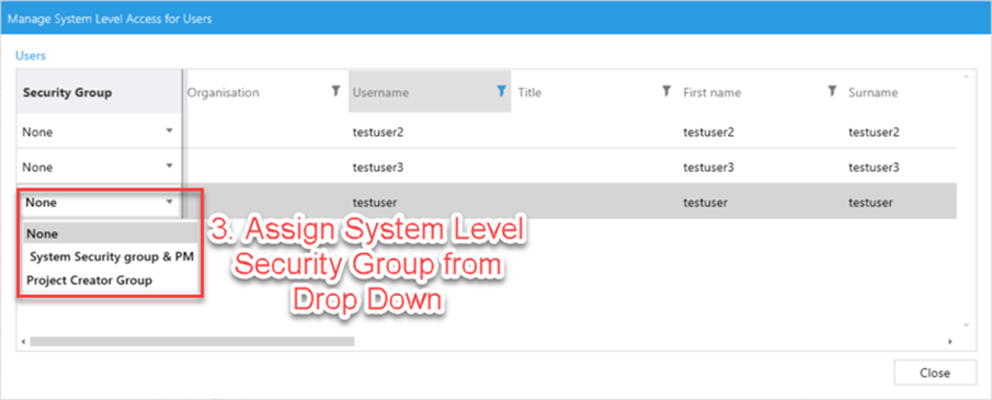

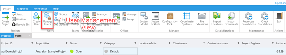

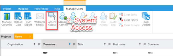

In User Management, select the intended user and open System Access. Choose the appropriate security group, apply the change, and review the user's assigned group. The screenshots below show the available controls and sequence.
First screenshot in the system-level access assignment sequence
Second screenshot in the system-level access assignment sequence
Final screenshot in the system-level access assignment sequence
