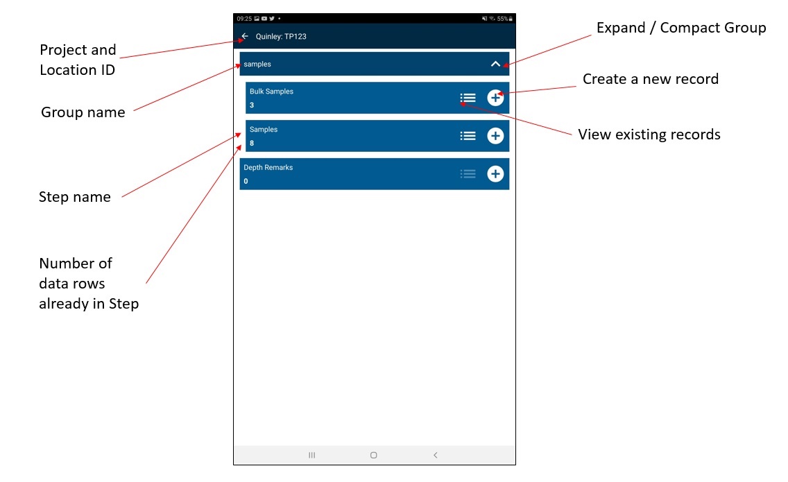

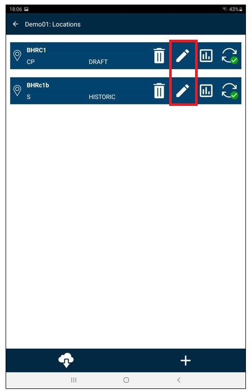

3. The location list will update to show the location.  Tap the edit icon to access the focused interface for data associated with the location (typically geological descriptions, samples, field tests, etc.)
4. Identity the required interface from the list and click the '+' Create New Record button on the right hand side.  Enter the data.
5. Repeat for the different types of data when need to be captured for the current hole.  Once complete tap the backarrow (top left) to return to the location list.

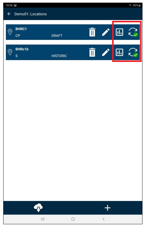

6. Tap the sync icon to upload the data to the cloud.  Tap the log preview to confirm the results if required.
