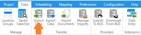

1. Open the required project and select 'Import Data' from the 'Data' ribbon:

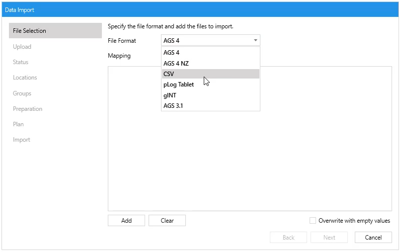

2. Select the format of the file, click 'Add' and browse through the file:
Click 'Next'.

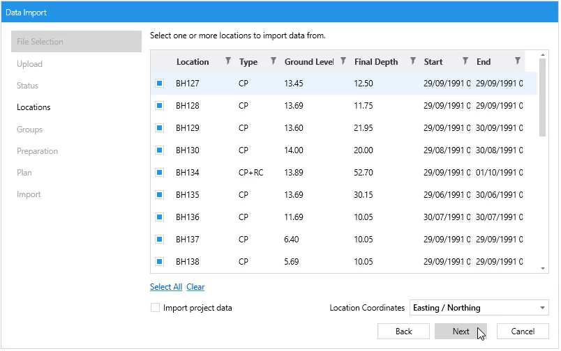

3. If there are no issues continue 'Next' until the 'Plan' stage is presented:
