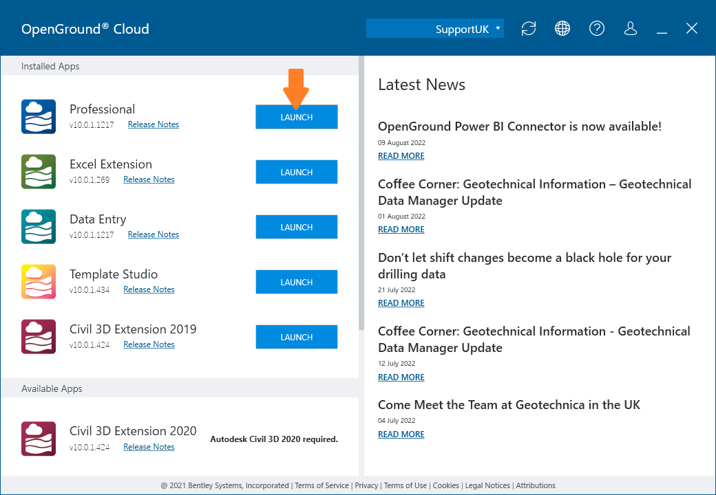

1. From the OpenGround Launcher click the 'LAUNCH' button associated with Professional:

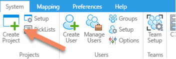

2. Click the 'Create Project' button from the ribbon:

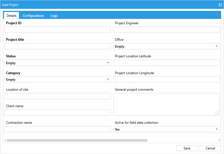

3. Enter the details in the screen shown below.  Note that bold items must be completed...

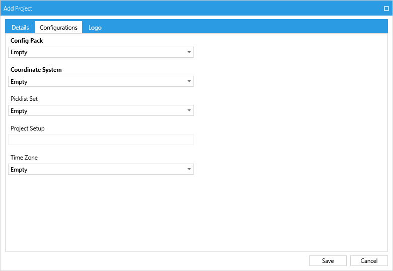

4. ...click the 'Configurations' tab and specify the required settings.  Note the bold items!
