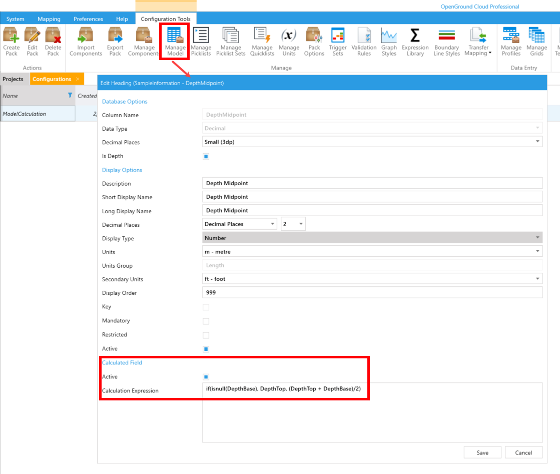

It is possible to enter a Model Calculation Expression by going to System>Configuration Packs>Manage Model and editing the desired Group and Header (or adding a new Header).

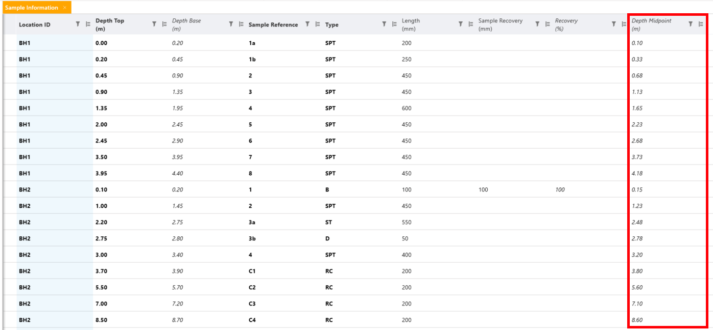

For example, the DepthMidpoint Header in the SampleInformation Group is calculated below using this expression:
if(isnull(DepthBase), DepthTop, (DepthTop + DepthBase)/2)

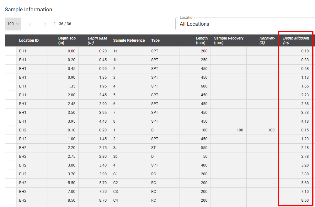

Within a Project, calculated Headers are indicated by italics in both Professional and Portal.
When data is entered and committed to the database, calculations are automatically performed, and the calculated values appear in the grids. Calculations are also performed when data is added/edited through the OpenGround API or during import.
Calculated Headers are read-only. Data also can not be imported directly into a calculated Header.
Calculations can be activated/de-activated by unchecking the Active option within Manage Model. The Expression will still be stored when de-activated, but the calculations will not be performed.
Entering or activating a Calculation Expression for a Header that already contains data will cause existing data to be overwritten when the calculations are processed.
