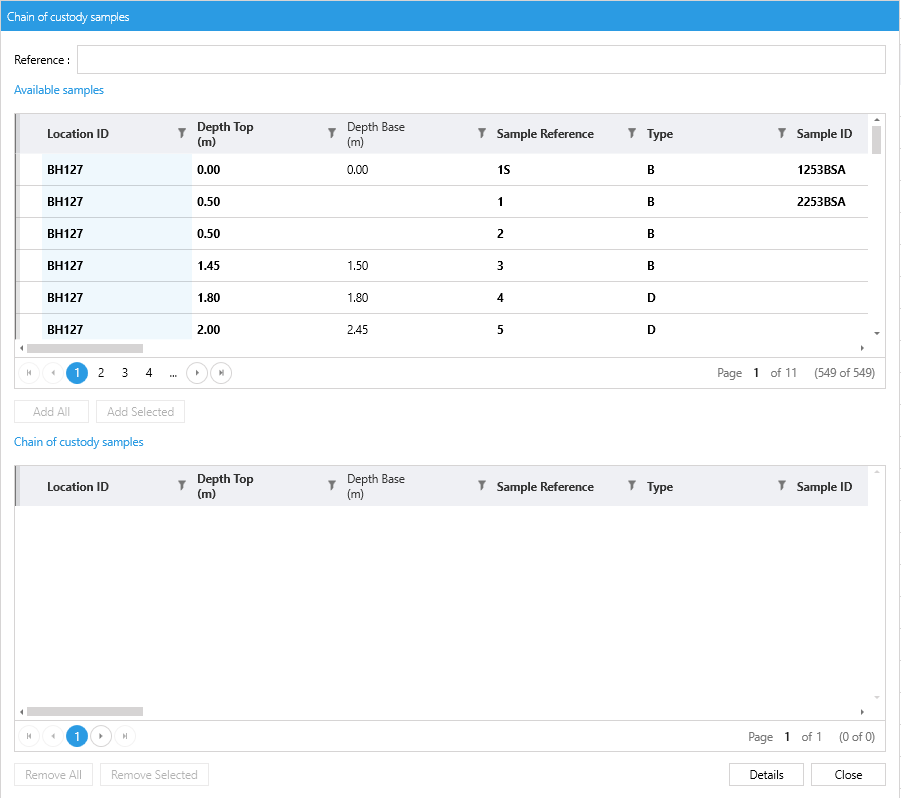

Chain of Custody
A Chain of Custody for Geotechnical or Geoenvironmental samples is a way to track the movement of samples from the field to the laboratory or any other place. This is managed in a project in OpenGround with the Chain of Custody menu in the Scheduling tab on the main project ribbon.
How to add a Chain of Custody
Don't forget you can use the filters in the interface to filter the grids to make sure you can access the sample you are working with.
You can manage the chain of custody within OpenGround to make sure the data and information stay up to date.

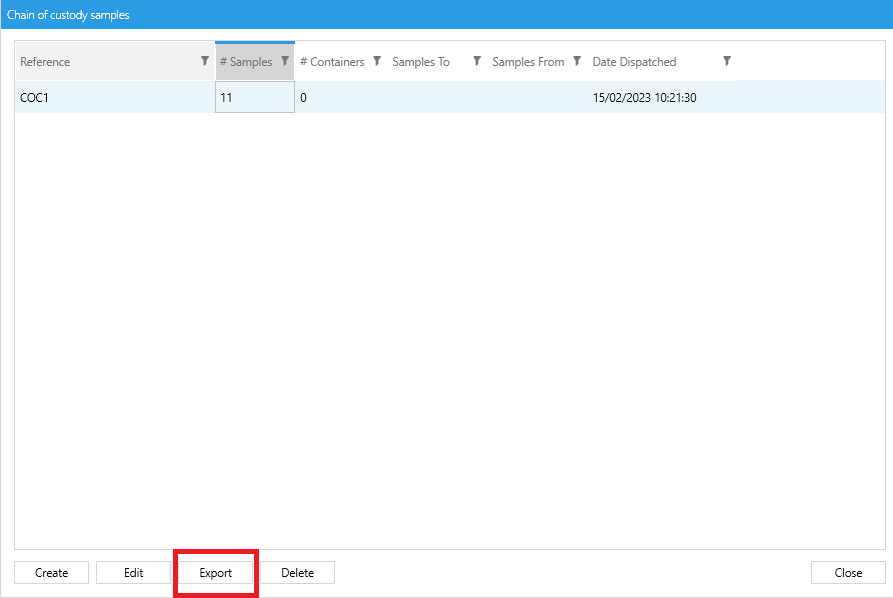

Managing Chain of Custody Data
The main ways this information is exported is with the AGS file from the manage interface and export
This data is also able to be expressed in Excel Extension to update clients if they are not able to use the AGS file.

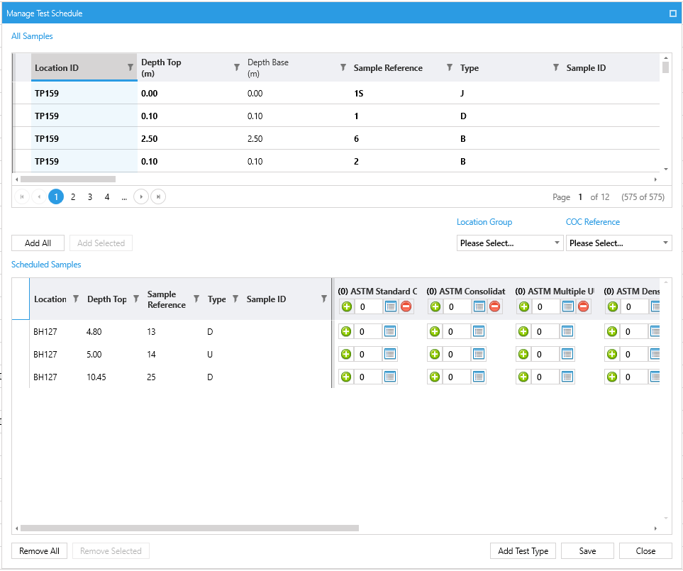

Laboratory Schedule
Laboratory Schedules can be part of a chain of custody or they can be set up independently. The laboratory schedule is the schedule of tests to be performed on the samples collected for the project. In OpenGround this can be accessed in a project on the scheduling ribbon.
Create Schedule
To create a new schedule for a project you can select the create Schedule. You can have as many schedules for a project as are needed.
Assigning Tests
Once you have created the schedule it self you need assign which samples are going to be part of this schedule and which tests are required.
This is where you can select the Chain of Custody (COC) or the Location Group you would like to use.
(Don't forget you can filter the data in the samples grid to find the locations and samples you are looking for).
