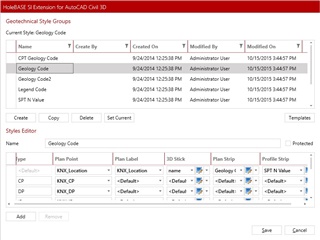

Command: HBSI_StyleManager
From the OpenGround Cloud ribbon click Styles to display the Geotechnical Style Manager.
The Geotechnical Style Manager is divided into two elements, at the top is the Geotechnical Styles Grid, and at the bottom is the Styles Editor.
The Geotechnical Style Grid lists all of the geotechnical styles defined and works like any standard OpenGround Cloud grid, with the column headers being used for sorting and filtering the data. Selecting a style by clicking on it in the grid will populate the Style Editor.
