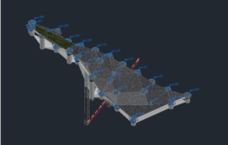

The Geotechnical Hatch Manager allows for assigning materials as well as colours to represent strata in the 3D geotechnical objects, these include the 3D boreholes, surfaces and fences.
Materials is a function within AutoCAD and will need to be assigned to a materials library and saved as a Drawing Template before they can be added to strata within the Hatch Manager. Consult AutoCAD help for details on creating material libraries and saving templates.
Once the Material library is created they can be selected from within the Hatch Manager.
Select a Geology and then select a Material from the Hatch Manager drop down list.
Press Save to confirm changes within the Hatch Manager.
Materials are not visible if the visual style is set to 2D Wireframe
The below is an example of how the materials may look represented on a drawing based off a previously saved template.
