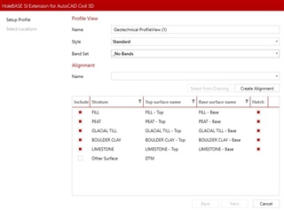

Create Profile View - Command: HBSI_CreateProfileView
From the OpenGround Cloud ribbon click Create to display the Create Profile wizard
Create Profile View works in the same way as the standard AutoCAD Civil 3D profiles; however they have the extra ability to project the required borehole log strips on to the Profile View and automatically hatch the strata areas.
The command uses a wizard to create the Geotechnical Profile.

 Step 1 - Setup Profile
