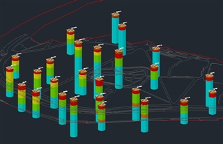

Hole locations are automatically generated when connecting to a OpenGround Cloud project and are represented by two main elements in the AutoCAD drawing.
Plan symbol: The marker representing the whole location on plan, this is made up from a Point and a Point label
3D Borehole: A number of cylinders representing the borehole in 3D; each cylinder represents different strata/banding down the borehole.
The way these elements look is defined by styles and are covered elsewhere in this guide.
3D Boreholes rendered
The location plan symbol is placed on one layer; the 3D borehole cylinders are all in different layers' dependent on their strata/banding name. All layers created are placed under the KNX group in the AutoCAD Layer properties.
