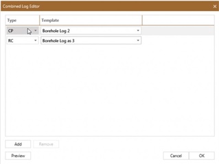

When you select the Combined Log option on the Templates Type Form (window) the Template Setup form (window) appears. It is possible to choose the paper size (A4, A3, etc.), the orientation of the Log (Portrait, Landscape) and the margins.
After that the Combined Log Editor form (Window) opens, press the Add button at the bottom of the form and select the template that is required to be associated with a given type of bore-hole (CP, RC, TP etc.).
The above pictured log (assuming that there is a borehole drilled initially by CP and later on with RC method) will create a log where the Cable Percussion part of the borehole will be presented with the use of the Cable Percussion Log then a line is drawn across the log at the change point and it will split from Cable Percussion to Rotary Core part of the borehole presented with the use of the Rotary Core Log.
The first page footer will be from the CP log and on the second page the footer will be from the RC Log.
