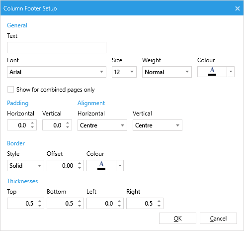

The footer area of a column can seem confusing as it has multiple purposes. The image below shows a footer area sitting below the depth related area and the main footer for the Log. The footer serves two purposes:
- To allow text to be placed at the bottom of the Log without spilling into the footer
- To add "Footer" text at the base of the column as well as the top. This is especially use-ful for combined logs.
To change the column footer settings, follow the steps below:
- Click the Depth Columns button on the Design section of the ribbon.
- The Depth Column window opens and under the Columns Group select the column name where the changes are to be made.
- Click the Footers button to display the Column Footer Setup form.
- Change the required settings and click OK.
