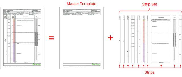

The primary unit for the design of templates within Template Studio is the meter, regardless of the final output units of the log. A borehole log is composed of several parts that are dynamically assembled to generate the final output. The main component is the "Master Template", which defines page size and margins, as well as containing the static header and footer sections of the borehole logs.
The middle section consists of vertical columns of depth-related information, which make up the bulk of the borehole log. An individual column (or group of sub-columns) is referred to as a “Strip”. When grouped together for a given report style, these columns are referred to collectively as a "Strip Set". A Master Template can have multiple Strip Sets available to it. Strip Sets are groups of individual strips arranged in a specific order and may also have strips with visibility conditions that will only be displayed if those conditions are met (for example, if PID readings are present).

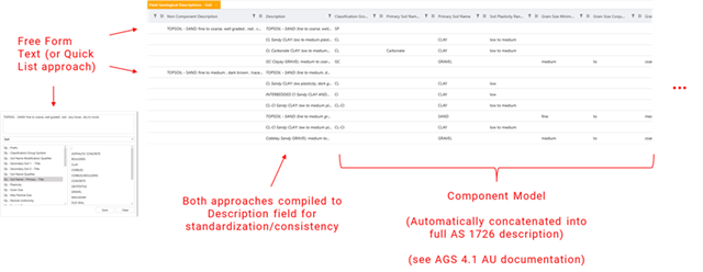

OpenGround offers both component-based and non-component-based methods for building geological descriptions of soil and rock. In a component-based approach, each parameter, such as colour, is saved individually in the database. These components are then assembled to create a generic description that can be modified to suit your needs.
The non-component-based description is essentially a free-form method of entering descriptions, allowing for faster entry at the trade-off of standardization and potential variations across users. Additionally, there is the ability to use “Quick Lists” to provide prompts on ordering and typical descriptors used for things like consistency or moisture value.
OpenGround will by default generate a description based on any values in the Component-Based Section, however, if there is a Non-Component Description present, it will use that instead to populate the Description field.

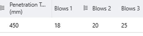

SPT Testing and N-Values
The way that Standard Penetration Test (SPT) results are summarized on a log output can vary between organizations. With the default settings in OpenGround, SPT results are summarized in the following way:
The table below shows some typical data entry occurrences and how they are reported on a log output:

3 intervals, full penetration (450 mm)
