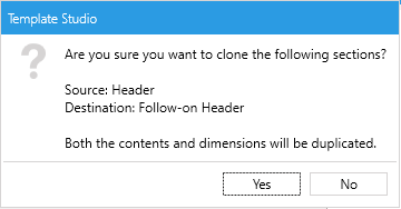

A warning reviewing the changes that are to be made will then appear:
Note that this will change all of the grids contents for that section, including the dimensions. If you wish to edit this afterwards then return to the Template Setup dialogue to make adjustments as necessary.
