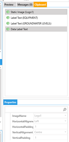

The other component of the clipboard is the Clipboard interface itself.
From within this interface, it is possible to select all of the items that have been copied into the clipboard, select the one that is required and then paste this into a merged area, either with the use of the paste button, or double clicking on the item in the clipboard.
