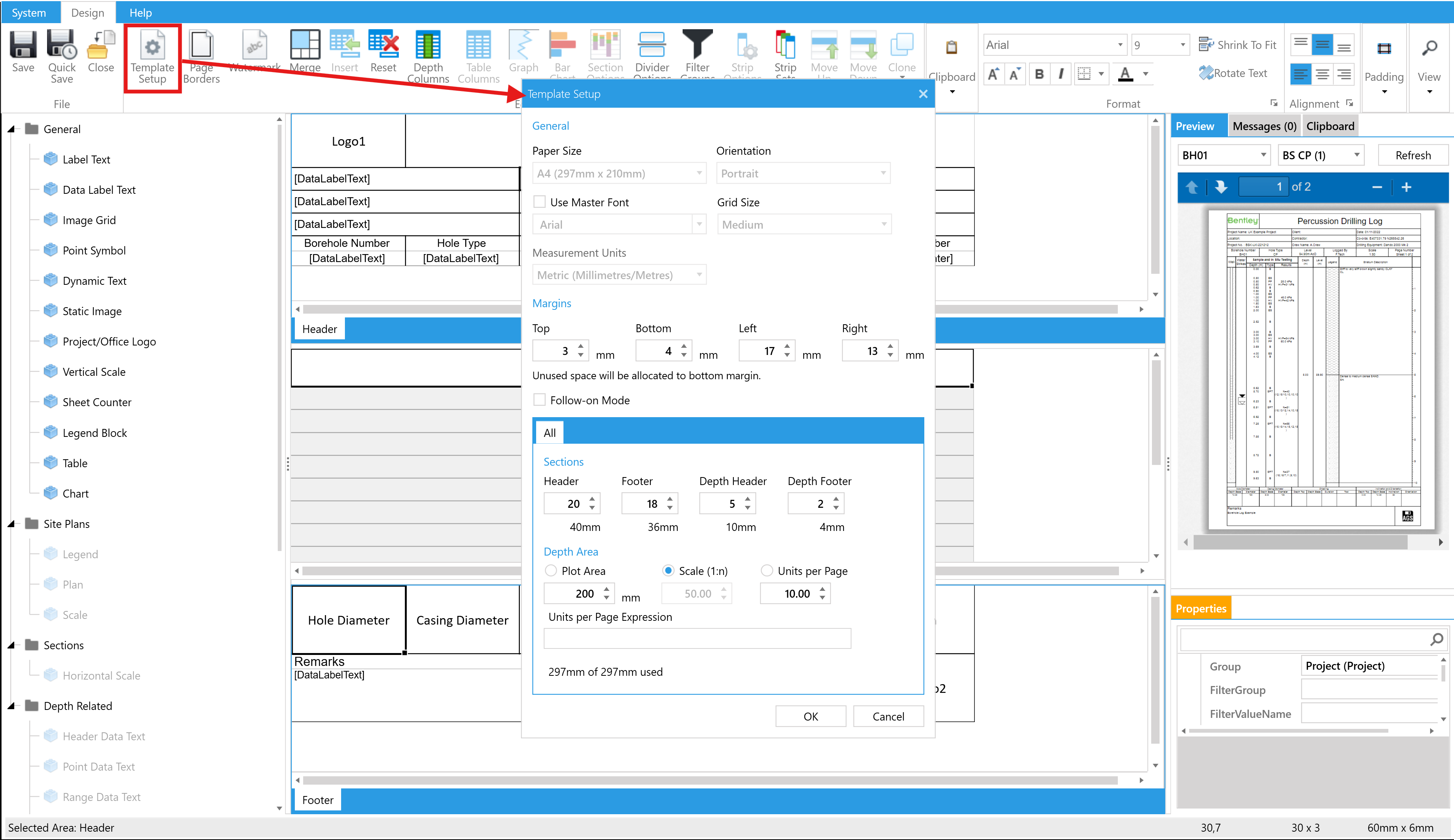

Click the Template Setup button to review the settings:
Some of these settings can be adjusted at anytime. Others can only be specified when the template is created; they are displayed here for information only and are detailed below:
- It is not possible to change the paper size and orientation
- It is not possible to change the Grid size
- If there are not enough rows at the bottom of the Header area that have not been merged then it is not possible to reduce the size of the Header area without un-merging the required amount of rows. The same restriction applies to the Footer area
- Increasing the size of the header or footer areas will add blank rows of grids to the bottom of the appropriate section.
- It is possible to change the Depth Header and Depth Footer headers as long as the overall log size does not exceed the paper size.
- It is possible to change the size of the margins (e.g., left and right). However, Template Studio will not allow for expansion greater than the width of the page. If the template is to be moved to the left or right you must therefore reduce one margin before expanding the opposite margin.
