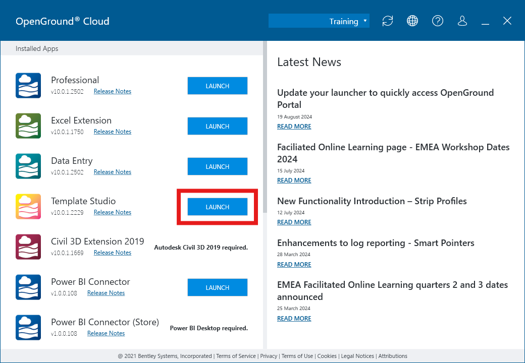

From the OpenGround Cloud Launcher click the Template Studio 'Launch' button to start the application:

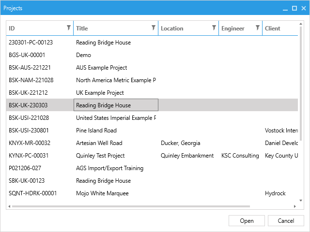

Select a project from the list presented:
This will allow the template to be previewed with the data from this project.  Note that you will need to have System Administrator access to fully distribute templates to OpenGround for use.
