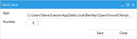

Quick Save
The Quick Save button captures changes without distributing them to the system. This serves is a useful informal backup that you can rapidly Load to restore. It can be equated to a manual version of the Autosave feature in Microsoft Office products.
This option saves a HBT file to a location on the local machine. This location can be located by browsing through to the System section on the ribbon and choose Save | Settings:
As shown above, the number of QuickSaves stored can be adjusted from the default of 5 up to a maximum of 10.
After reaching the specified number of QuickSaves the existing local HBT files will be replaced in sequence by each subsequent save.
This form also displays the location on the local machine that QuickSave is using. You are not able to change this location.
