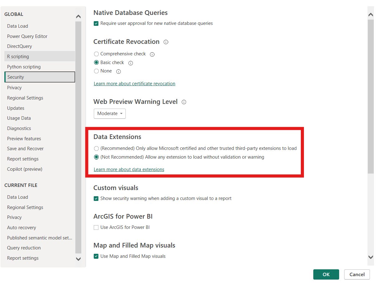

Troubleshooting
If the OpenGround Connector does not work, then check the security settings and ensure the following option is selected as this release of the Power BI OpenGround Connector is not certified yet.
