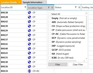

To apply a filter to a grid, select the Filter icon next to the column name and enter the criteria for the filter. If a filter is currently applied, then the filter icon will turn blue to represent this. More than one filter can be applied to any one grid at a time.
To remove a filter, select the same option again followed by the Clear Filter option.
Note: Depending on the type of data being held within the column, the options for filtering will differ. The different types of fields are Pick lists, Text, Numeric, Date and Date/Time.
Pick lists – Pick list filters allow for a selection box to be checked to allow for the user to decide if the data should be displayed or not. Note the option to select all and empty fields.
Text -Users can filter text values with the standard filter conditions found in applications like Excel. In addition to these it is worth noting the Empty option. This option has been made available to allow for users to quickly show/hide data that has no values entered within a column.

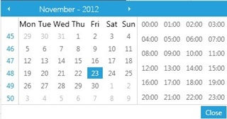

As well as the option to filter empty data there is also the option to filter by date. This can be using either just one condition (e.g., after a certain date) or two conditions (e.g., between two date periods). To use the filters, select the first drop-down list and select the first condition. See the section on Filter Conditions for further information on filter conditions. Then select the calendar icon next to the first filter box and a date dialogue will appear in a calendar format allowing for the date to be selected as required.
A further condition can then be added by repeating the above process using the second drop-down list and calendar options.
Date/Time – Date/Time filters are the same as the date filter but also allow the user to specify times within a specific data
A further condition can then be added by repeating the above process using the second drop-down list and calendar/time options.

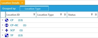

Grouping Data
Data can also be grouped within a grid to give a quick overview and breakdown of what is available. To quickly group data within a grid, select the grid that is to be adjusted, then choose the header that is to be grouped upon. Select the furthest most right icon within the header, this will then group the data.
A list of all the different values will then appear within a grid showing a count of the amount of times the value appears within that heading. Clicking on a value will open a new grid with all of the data containing that value.
This process can be repeated multiple times to allow for data to be drilled into. Just simply select the group heading option from within the filtered set of results and the above process will repeat.

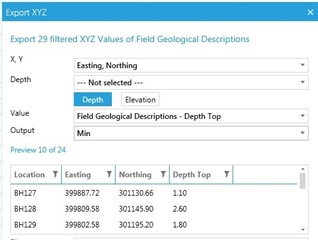

In the above example there was only one value that could be exported. However, when you look at creating XYZ data from other grids it is important to understand how the grid filters and the output drop-down options can work together.
For example, if you wish to create an XYZ file where the Z value is the depth to the top of a geology layer then you can specify a filter condition in the grid and use the "minimum" option in the output drop-down. The steps below detail this process:
The output drop-down contains the following options which should be sufficient to cover all options you need to use to create any XYZ data:
The final area of XYZ data to discuss is the option to create an XYZZ file (sometimes called XYZ Value file). This also produces a simple text file, but this time it will have 4 columns, X and Y are the same as above, Z is the depth for a value and the final column is the value at that depth.
This type of file could be used to export a data for the depth and maximum values of all Arsenic in a project by following the steps below.
