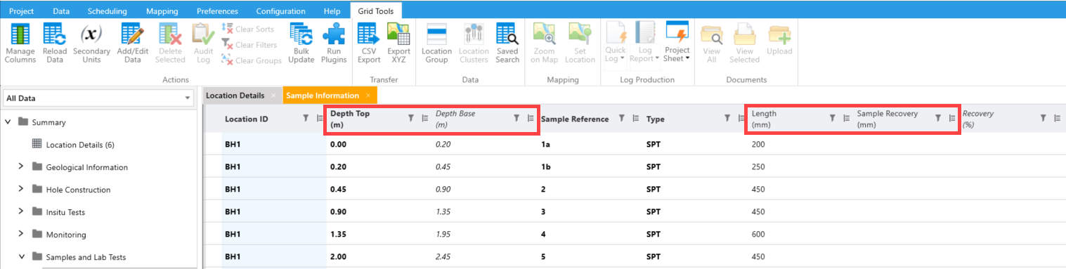

For example, in OpenGround Professional, data will be shown in the Primary Unit by default:

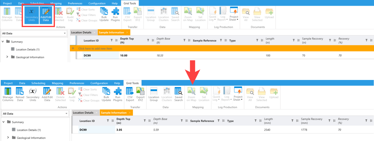

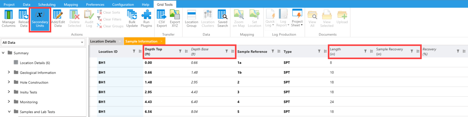

If you select Grid Tools>Secondary Units, the data will be shown in Secondary Units.
You can then select Grid Tools>Add/Edit Data. Any data entered with Secondary Units activated will be automatically converted to Primary Units.

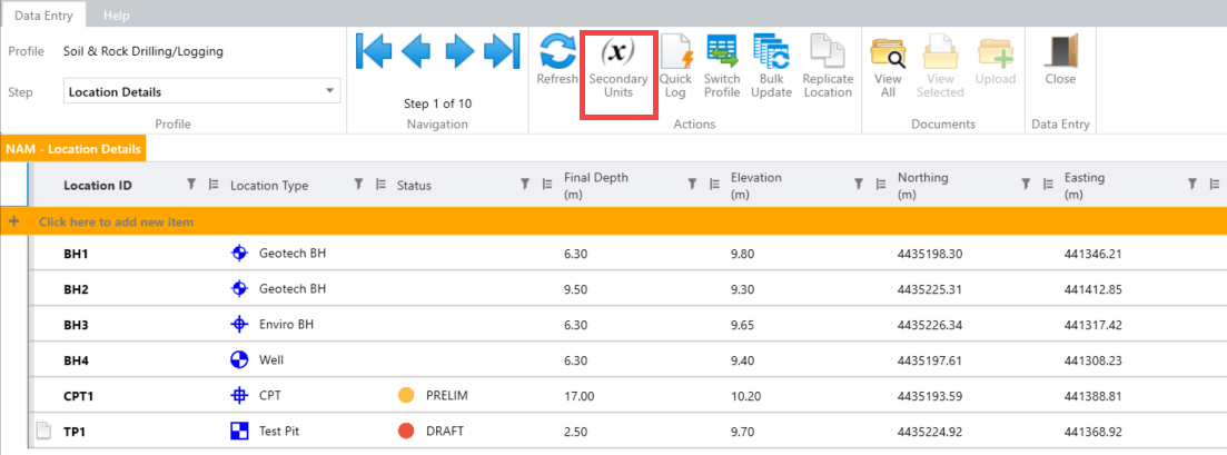

Other applications, such as the Data Entry module, also have similar capabilities to view and edit data using Secondary Units.

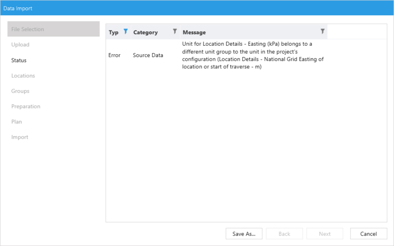

Unit conversion is supported during AGS file import. If the UNIT defined in the AGS file is different from the Unit (Primary Unit) for the destination header in OpenGround, the value will be automatically converted to the Primary Unit.
The AGS UNIT must be in the same Unit Group as the Unit for the destination header (for example, both must be units of Length) or errors will be encountered during the import process with a message similar to below.

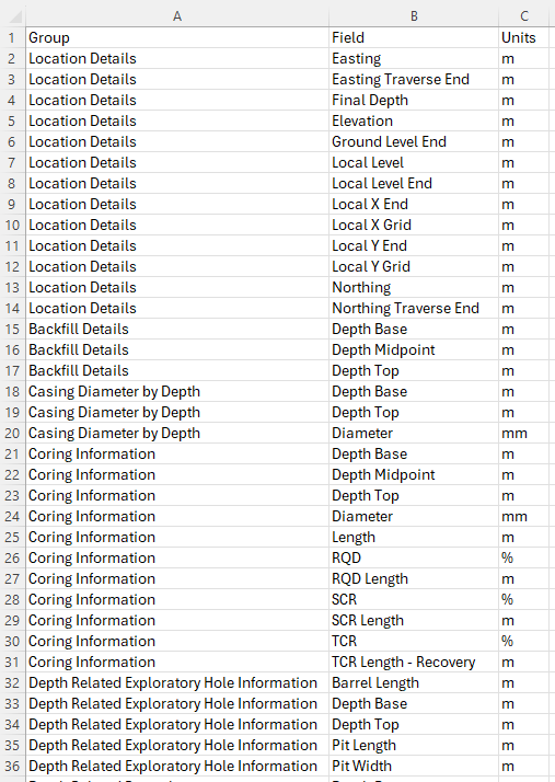

Unit conversion is also supported during CSV file import. For unit conversion to be performed, the CSV files must be packaged within a .zip file and there must be a UnitMapping.csv included. Unit conversion is only performed for headers with a 'Decimal' Data Type.
UnitMapping.csv lists the units for each field within the CSV files.

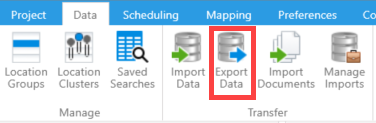

If you export a file to CSV using Data>Export Data, it will automatically include the UnitMapping.csv.

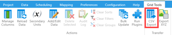

Note that if you export a file to CSV using Grid Tools>CSV Export, this does not generate UnitMapping.csv and instead only generates a single CSV file for the active grid.
As with AGS import, the source unit within UnitMapping.csv and destination Unit for the OpenGround header must be in the same Unit Group or errors will be encountered during the import process.
