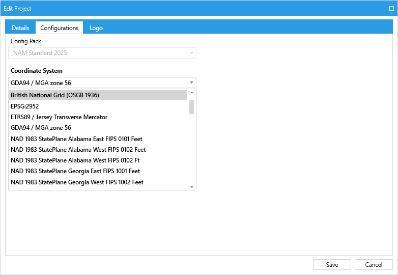

  2. Go to the Project tab.
  3. Select Project Details.
  4. Navigate to the Coordinates tab and pick the new coordinate system.

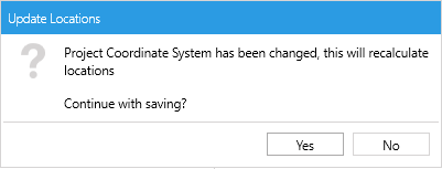

  5. Click Save.

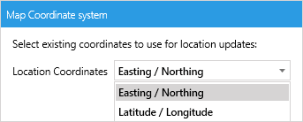

  6. You will then be asked to chose either Easting/Northing or Latitude/Longitude. Which ever one is picked, those values will not be changed and the others will be recalculated.
