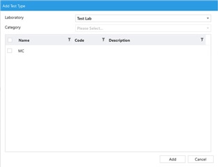

The tests that will be assigned to the samples then need adding from the available tests that have been imported into the relevant laboratory in OpenGround Cloud Professional. Select the Add Test Type button from the bottom of the form.
Select the required tests from the list and then select the Add button. The dialogue will then close and show the Manage Test Schedule form with the tests now added.

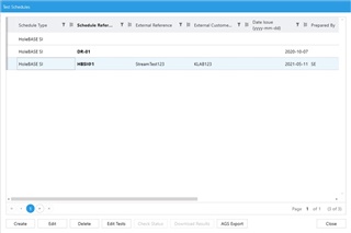

Select the Save button to save the changes to the schedule. A test schedule can then be exported via an AGS export by selecting the AGS Export option from the Test Schedules form.

If you have imported a test schedule into HBSI or wishing to amend the status or already scheduled tests and exporting the updated schedule as an AGS file you can do this from within the Manage Schedule area of HBSI.
First select the schedule you wish to update and select Edit Tests.

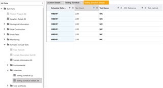

After making the amendments the results will be displayed within the Test Schedule Details grid.
Please note that it is possible to bulk update all tests within the grid or filter for specific tests, but you cannot edit individual tests as this grid is not set up for add/edit mode.
