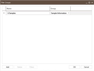

- Select the Design Ribbon and Select the Filter Groups button as below:
- The New Filter Groups window will then appear, enter a name for the Filter Group and select the group that the Filter Group is to be based upon.
- Once this has been done, select the Filters button to then add either a grouping or a filter as needed.
