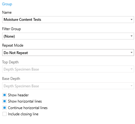

Group
In this group, choose the Group from which the data will be retrieved from e.g. Casing Diameter by Depth or sample information. You can control the filer groups as well as what the table will do at a page break in the repeat mode.
Repeat Mode
This will control what happens with the data in this table when a new page is created. it will either not repeat or i can repeat.
Repeat Mode
Top Depth and Base Depth are used on a table on a log template, which lets it control when tables which can show data on a log on the page, the depth range is shown. If do not repeat is selected, the table will only appear on the first page of the Log. It will continue to the second sheet only if the table lines are too many and they do not fit on one sheet. If for example, there are 7 rows of data and the table space can only fit five rows, the remaining two will print on the second page even if this option is deselected.
Show header
Select (selected by default) or deselect depending on whether a header is required for the table.
Show horizontal lines
This can also be selected (not selected by default) if there should be horizontal lines between the rows of data.
Continue horizontal lines
This will keep the horizontal lines across the page for each of the rows not populated. This will be based on the row height and works best if you have fixed row heights.
Include Closing Line
This will redraw the list line on the page, only used if you do not set continuous horizontal lines and fixed row heights.
