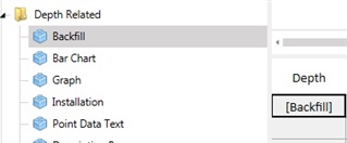

To insert a backfill object into a column, follow the steps below:
- Select the first empty box below the column headers that the item is to be added to.
- Double click on the Backfill Object in the Depth Related section of the left hand side tree view.

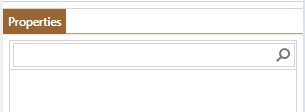

- The Backfill object will now be added and the text "[Backfill]" is inserted in the cell. The backfill object has no additional properties to define.
- Refresh the borehole preview to see the changes.
