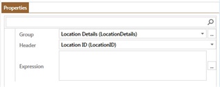

Header Data Text objects connect a cell to the OpenGround Cloud database dynamically. An example of that is the Borehole ID.
To insert a Header DataText Object into your template, follow the steps below:
From the Header drop-down list box choose the database field from which the information will be retrieved (e.g., Location ID).
The expression box can be used instead of the Header drop-down. To add a predefined expression, click the … button on the right hand side of the box. For more information on Expressions see the Expressions Chapter in this user guide)
Text and font format can be changed from the general cell format on the Design section of the ribbon.
