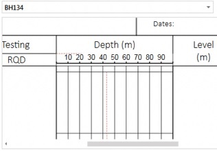

Scale Tab
- This tab set up the scale bar at the top of the graph.
- The physical scale is set up using the initial value, increment and count. For example, a scale from 0 - 100 with gridlines every 20 units would be set up as Initial Value = 0 Increment = 20 Count = 5
- The Marker Height is the height of the ticks on the scale bar and the display format is the number of decimal places to display the numbers on the scale.
- The final sets of options are self-explanatory.
