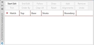

From the OpenGround Cloud ribbon Interpretation Panel press the Editicon which will display the Interpretation Manager dialog to edit geotechnical profile views.

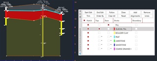

- Start Edit: Press Start Edit and select the geotechnical profile view from the drawing to work with. To select a profile view, click on the profile view border or gridlines.

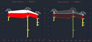

Selecting a profile view will put the profile view in edit mode and change its appearance, apply-ing transparency to the strata hatch areas and boreholes, profiles styles will also be changed to highlight the current profiles being edited, emphasising the vertices on the profile.
Note: It is recommended to set the AutoCAD Transparency Display On (TRANSPARENCYDISPLAY) and Line weight to show (LWDISPLAY).
The Interpretation Manager dialog will also be updated to list the strata in the project and activate the buttons.

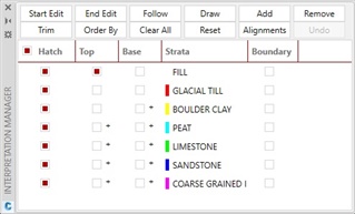

For each stratum listed the following options are available:
- Hatch: Toggle On or Off to display the stratum hatch band
- Top: Toggle On to make the stratum top profile editable
- Base: Toggle On to make the stratum base profile editable
- Highlight: By clicking on the stratum Name in the list, the Stratum band in the profile view will be highlighted. The actual amount of transparency and the profile styles used are defined in the Interpretation Settings command.
- Boundary: When toggled On displays vertical lines where the intersection of boundaries occurs with the alignments for any boundaries associated to the stratum surfaces
To edit a profile toggle On the appropriate profile to make it editable, either the Top or Base; multiple profiles can be edited at the same time by toggling on the appropriate check boxes.
Only profiles that coincide should be edited simultaneously otherwise undesirable changes will be made.
