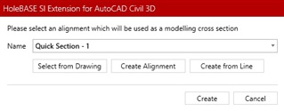

From the OpenGround Cloud ribbon Interpretation Panel press the Create icon, to display the Interpretation Create dialog.
The command gives four options for either creating a new alignment or selecting an existing one:
- Name: from the drop-down list select the alignment
- Select from Drawing: Select the required alignment from the drawing
- Create Alignment: Follow the prompts to draw the alignment line and press Enter when done; An alignment will be created ready for use.
- Create from Line: Select from the drawing an existing line, polyline or feature line to use to create an alignment, the original line will be left intact.
- Create: Once an alignment is either created or selected press Create and click the bottom left location for the profile view.
