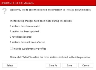

From the Civil Extension ribbon Interpretation Panel, press the Save icon to display the Interpretation Save dialog.
The dialog displays information on all the interpretation profile views, called sections, in the drawing.
