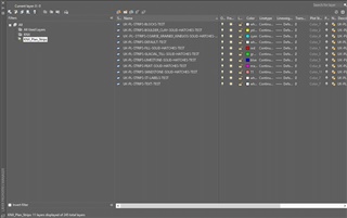

The AutoCAD 3D Layer Properties Manager can be used to show all layers in the drawing. Using the ACAD command LAYER to bring up the Layer Properties Manager dialog.
The visibility of layers can be toggled on/off and customising the appearance is also possible. Please consult the Autodesk Civil 3D help or user manual for further information.
Note: Geotechnical layer colours, materials and transparency can be changed in the standard AutoCAD layer manager for the current drawing independently of the styles saved in the Hatch manager. This gives control over the current drawing.
