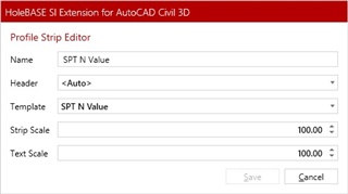

Plan Strip Editor
Creates and updates Plan Strip styles
- Name: Enter a name for the style
- Header: The AutoCAD Civil 3D point label style used to locate the location on the Profile View, <Auto> refers to KNX_Strip_Header, the default point label style created by the Geotechnical Extension. The style can be edited although it is recommended a copied version should be updated.
- Template: Select the strip template to use. Strip templates are managed with the Template but-ton on the Geotechnical Style Manager
- X Offset: The horizontal distance to position the top left/right of strip from borehole location.
- Y Offset: The vertical distance to position the top left/right of strip from borehole location.
- Strip scale: The scale for the plan strip relative to the default size. Changing the strip scale also changes the strip text scale to match the entered value. The text scale can be altered inde-pendently however.
- Text Scale: The scale to change the text size independently to the strip scale. Note: Plan strips now use annotative text.
- Save: Click Save to store the Plan Strip style definition
- Profile Strip: Defines the appearance of the borehole Profile Strips. It uses Profile Strip styles and Strip templates saved in OpenGround Cloud . Select the Profile Strip style to use or click the down arrow to see the three options: Create New, Copy Current Selection and Edit Current Selection, to create new, copy or edit the Profile Strip styles.
