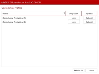

Command: HBSI_ProfileManager
From the OpenGround Cloud ribbon, click Manage to display the Manage Profile dialog If hatch styles or Profile Views are modified, it is possible for the profile strips on Geotechnical Profile Views to go out of position or display out of date hatch styles. The Manage Geotechnical Profile dialog is used to rebuild and refresh the Geotechnical Profile Views.
Geotechnical Profiles
The geotechnical profiles grid lists all of the Geotechnical Profiles Views created in the current drawing.
- Rebuild: Click Rebuild to regenerate the specific Geotechnical Profile View
- Rebuild All: Click Rebuild All to regenerate all Geotechnical Profile Views in the drawing
Profile View

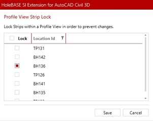

- Lock: Click Lock to display the Log Strip Lock dialogue to control locks on the selected profile view. Placing a lock on a log strip will prevent it from it being accidentally updated when the Pro-file View is redrawn.
- Lock: Check on the boreholes to lock, once locked the log strips will not update even if the underlying data changes, the only time log strips will be updated if if the alignment moves.
- Save: Saves the Lock state
