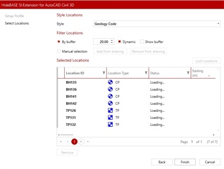

The Select Locations page is used for two functions, selecting the Geotechnical Style Set to use for the borehole logs and picking the locations to use in the profile.
- Style: Select from the predefined list the style to use when creating the borehole log strips on the profile. Refer to the Geotechnical Style Manager to see how to create styles.
Filter Locations
- By Buffer: Enter a distance to use to find all borehole locations within the specified distance from the alignment.
- Dynamic: Toggle On dynamic for the Geotechnical Extension to search for new borehole locations within the buffer distance to project onto the Profile View when the alignment is modified.
- Show Buffer: Draws a polyline to highlight the extents of the buffer.
From Drawing: Press Select, to be prompted to select locations from the drawing, pick the borehole locations to project onto the alignment and press enter.
Finish: Clicking Finish will prompt the user to specify the insertion point for the Geotechnical Profile with a mouse click. The Strata profiles with the borehole log strips projected onto the Profile View will be created.
Note: Switching to manual selection from buffer will retain the selected buffer boreholes.
- Back: Return back to the previous step
- Finish: Clicking Finish will prompt the user to specify the insertion point for the Geotechnical Profile with a mouse click.
