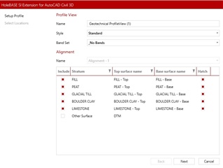

Step 1: Selecting a Profile to Edit
From the Civil Ribbon Click Edit. Use the mouse to highlight and select an existing Profile View.
The Geotechnical Profile Wizard will be displayed (Create and Select alignment is disabled).
The following can be edited:
It is also possible to add non-strata surface Profiles to the profile view, these will be listed in the Geotechnical Surfaces grid.

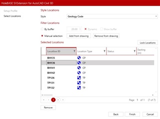

Step 2: Select Locations
This Step in the wizard mirrors that of the Location selection process when creating the profile initially.
Style Locations:
Style: Select the Geotechnical Style specifying the Profile log strip style to be used on the Profile View;

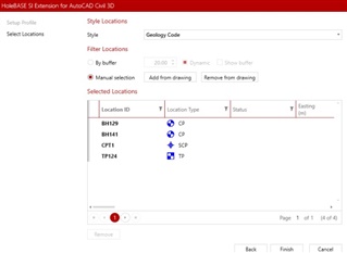

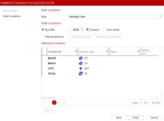

Step 3: Filter Locations
Note: Switching to manual selection from buffer will retain the selected buffer boreholes.
The below example illustrates adding a location to the Profile View from Plan selection along with toggling off the strata banding and hatching for FILL.
Manual Selection is chosen, and the Add from drawing selected.
A location from the Plan view is selected and the location appears in the Wizard after the Return key is pressed.
Press finish to finalise the changes being made. The Profile View will be updated to reflect this immediately.
