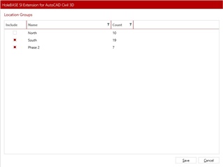

The groups command is used to control which groups display after the drawing has been connected to a project. When groups are included or excluded the drawing data, boreholes, sur-faces and even profiles are updated to reflect the new selected groups.
Location Groups - Command: HBSI_LocationGroups
From the OpenGround Cloud ribbon click Groups to display the dialog box.
Use the Location groups to specify which OpenGround Cloud location groups should be included or excluded from the current AutoCAD drawing.
Toggle Include ON to activate a Location Group, the borehole locations associated to the Location Group will be created and made active when Save is pressed. Toggle Include OFF has the opposite effect with the associated boreholes being removed from the drawing. In both cases any strata surfaces and geotechnical profiles will also be updated to reflect the changes. Note the Manage Profiles command may need to be used to rebuild the profiles
Save: Saves the settings and closes the dialog box, the drawing will be updated to reflect changes.
