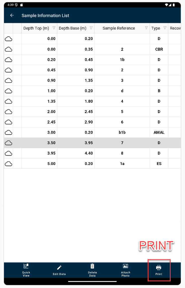

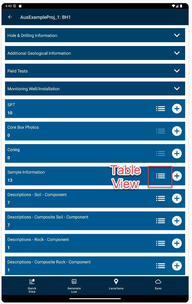

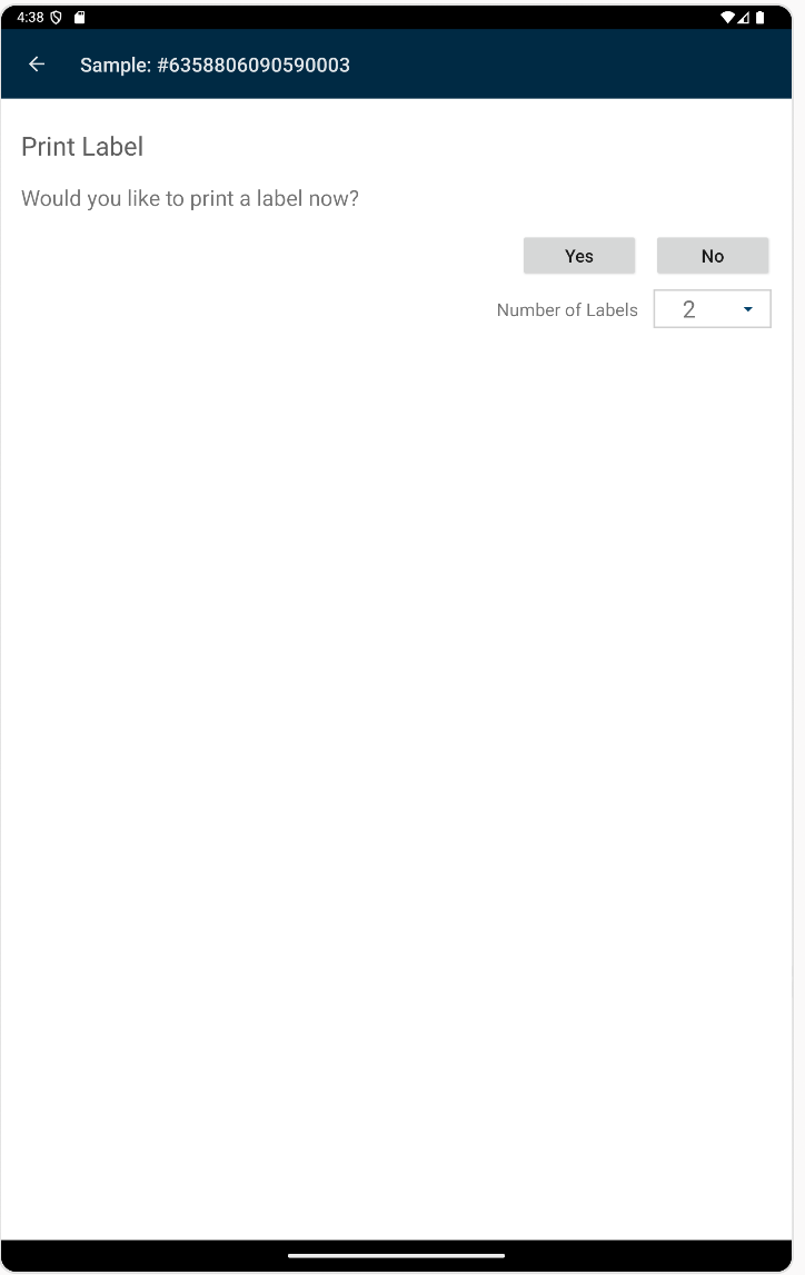

The administrator can set up an "Action" prompt to print sample labels when you save the data. Alternatively, you can also navigate directly to your sample information table to print a sample labels following the steps below:
